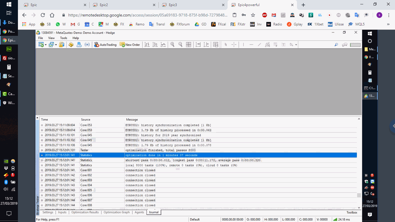

i forgot to show where it's possible to see the final elaboration time
it's in the last bottom right tab, called JOURNAL
start back from the final rows and go up of some ones
you will find a row like this "optimization done in XXXX minutes"
here is a screenshot www.siolibros.net/temp/coreprio.gif
