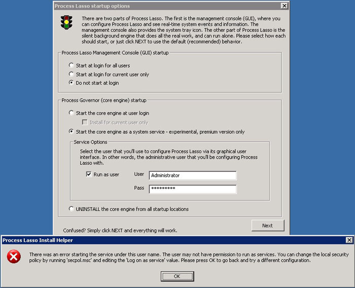

Hi, the latest versions have shown error when trying to install processgovernor as service.
The latest version is uninstallable for me.
I am running a Vista x86 on this machine and I get almost the same problem on my Vista x64 machine at home.
I get the same error but I managed to install it somehow.
The error I get is:
There was an error while attempting to install or uninstall the process governor service Please press OK and go back and try a different configuration.
I have tried to install it on a local account and on my domain account.
If I install it using system account it works and I can then go in in service manager and change the login for it to my domain login user.
Any idea why this has started in the latest builds? And does anyone else experience the same problem or are my computers screwed up?

I noticed that I can't run the service as a domain user  e. g.  'domain\administrator'.  It tells me that the user doesn't exist.
Quote(0x00000421): The account name is invalid or does not exist, or the password is invalid for the account name specified.
I work around this by modifying the service manually.

Ok, v3.35.0 beta is now available for download. You'll need to utilize a full UNC path to the user for non-local accounts. Also, I haven't tested the changes well (doing that shortly), so there is some possibility it still doesn't work right in this beta.

I just downloaded and installed 3.36.1 (32 & 64bit) and I'm still having issues configuring the service for a non local user account.
Maybe I'm doing something wrong?  I'm entering the user as 'domain\user' then the password, but it keeps giving me error 0x00000421:  The account name is invalid or does not exist, or the password is invalid for the account name specified.
Any ideas?
Jeremy Collake
I'm sorry, I made a mistake in the string parsing. I see it clearly here, and am correcting it for v3.38 final.

I have successfully installed the x64 version using a non local account, but it isn't working for the x32 version.
RDMTECH
I have successfully confirmed that I am an idiot!  :'(
It's working....I had a typo!
