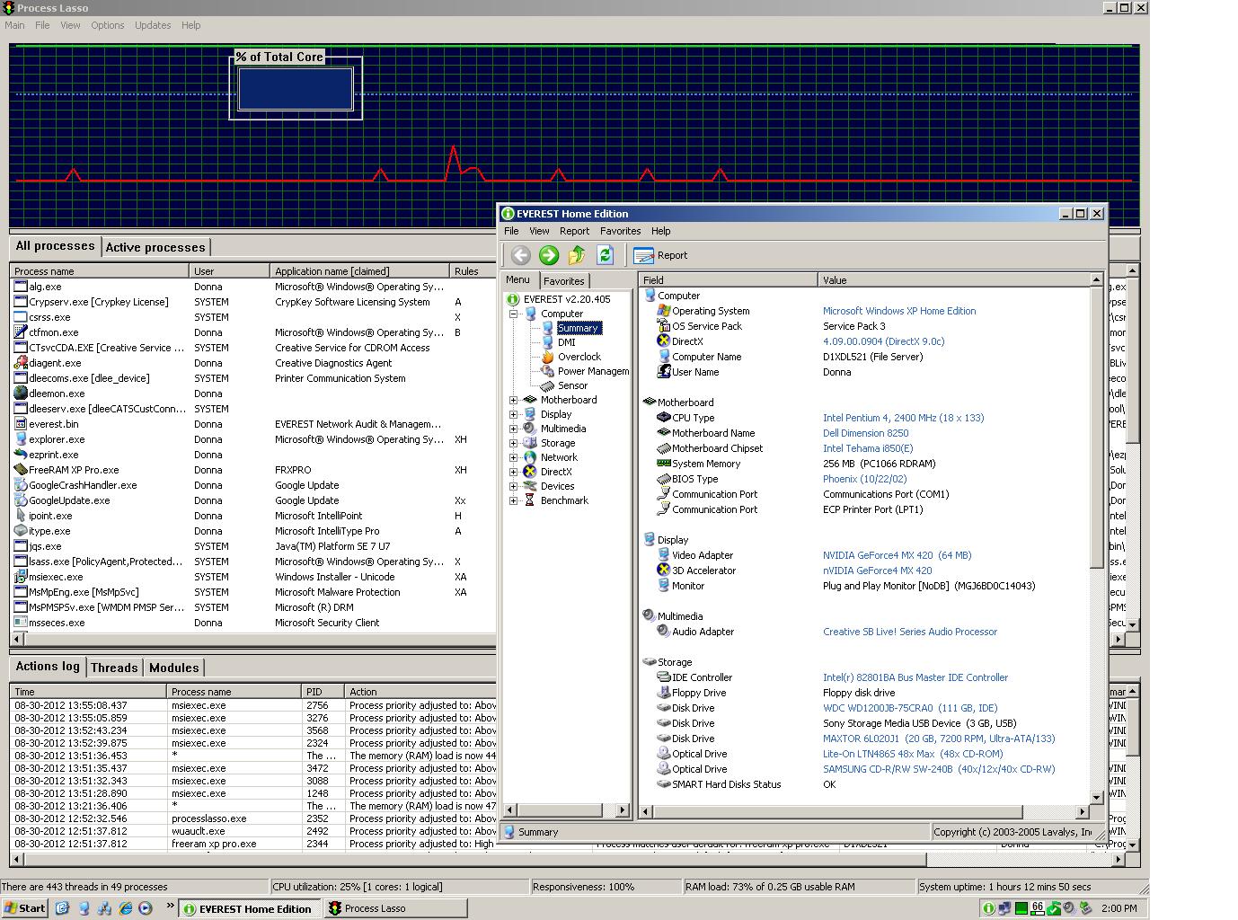

This is my only box showing an empty % Total Core Usage frame. Admittedly this machine is slow, obsolete and RAM challenged(it will be my first trade out), but I thought others might be seeing this as well.

This is likely due to two different sources used for the calculation. The one shown in the status bar is accurate. The failure of the per-core metric is likely due to a failure in the Performance Counters. When this is the case, the per-core usage is supposed to not be shown (window totally hidden). Have you made any tweaks to disable Performance Counters?

Let me ask, has this per-core metric ever worked on this PC? I assume not. It surely has something to do with a failure in the Performance Counter subsystem, but I'll hold off on further speculation.

I don't think it has. This system crawls due to the hard to find 256 Mb RDRAM. You will notice the heavy load even though the system is actually doing nothing at all in my screen shot.

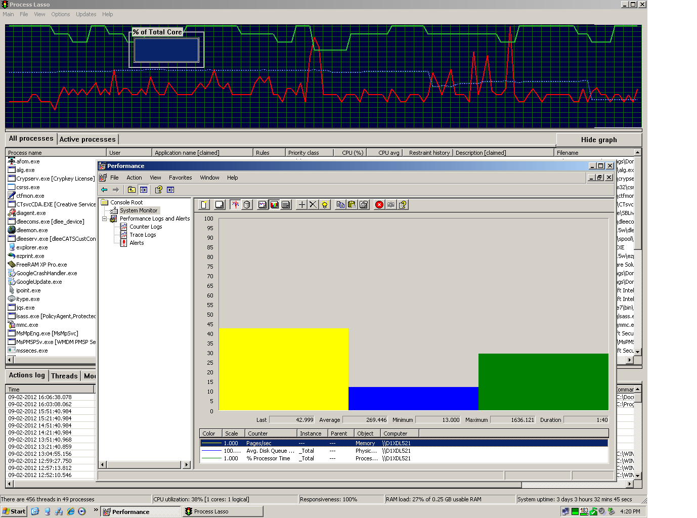

I would be curious if perfmon works on this system.. with it, you can add the same counters that Process Lasso is trying to display. If it works to display the per-core (actually single CPU) %, then it is some problem with Process Lasso.

Is this what you mean?
Jeremy Collake
Yes ;). Thanks. Another piece of the puzzle, or clue rather.

The actual performance counter used is \Processor(0)\% Processor Time , FWIW. I am wondering if this has something to do with the PDH helper DLL version installed on this PC.
